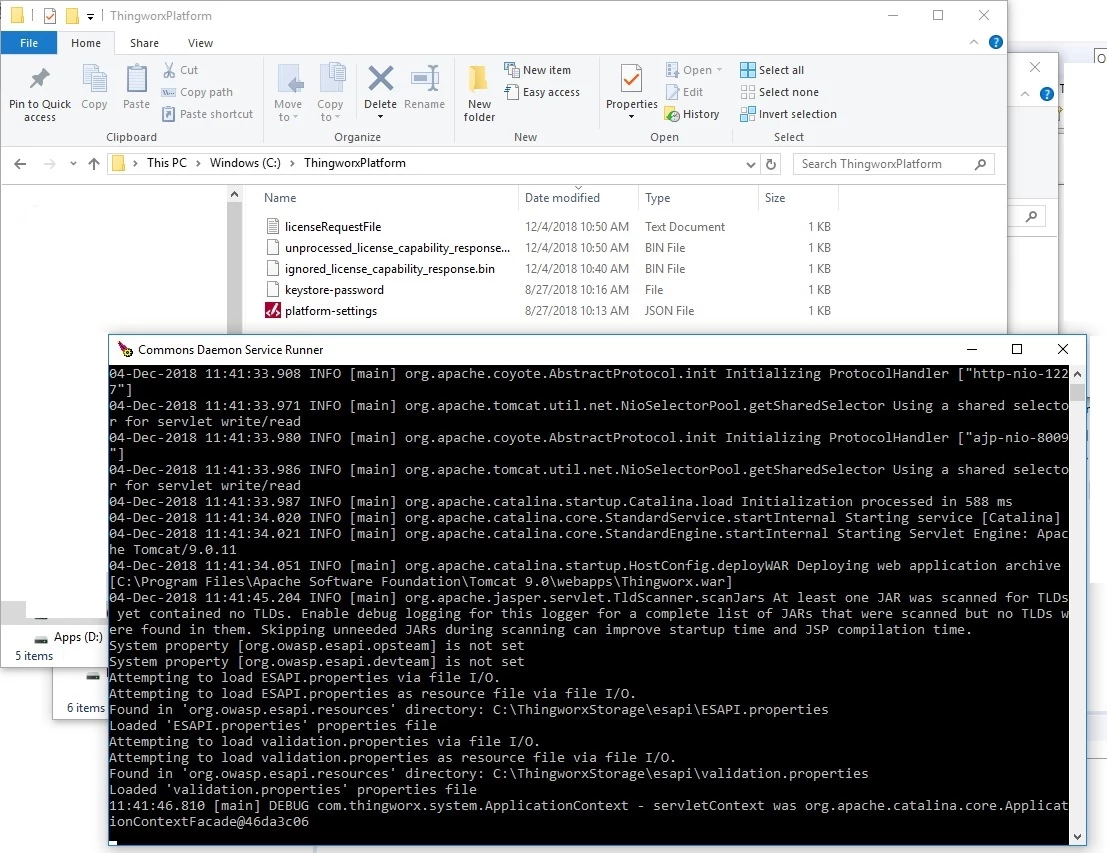

I am currently using ThingWorx 8.3.1.
ThingWorx was working perfectly fine in my local system as well as the AWS instance that I have.
All of a sudden both of them failed and the license in ThingworxPlatform changed from "successful_license_capability_response" to "ignored_license_capability_response" and "unprocessed_license_capability_response".
This happened in both the AWS instance as well as my local system.
The tomcat server closes after the last line of in the attached screenshot
I also tried downloading a new license with the device id obtained from the "licenseRequestFile.txt" file.
However, same error occurs.
This is the application log -

I checked your entitlements and see that they look fine, but when I attempt to generate a license for your company, it comes up empty.  That indicates there is a problem updating the FNO server with your entitlements that were renewed recently.
I will open a case with the License Management team on your behalf to get this addressed.
