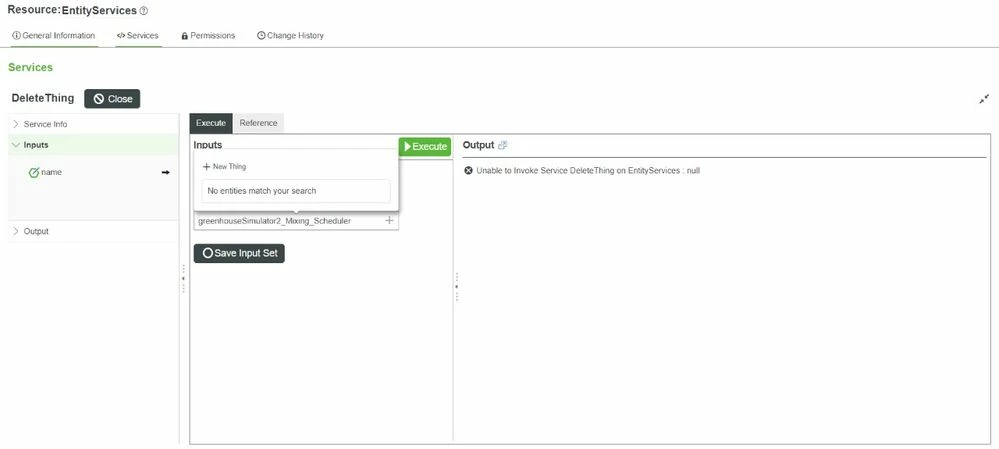

Last Friday, I deleted a scheduler thing named greenhouseSimulator2_Mixing_Scheduler via Composer. Today, I want to create a scheduler thing with the same name using a service inside greenhouseSimulator2 thing, but this error appears:
greenhouseSimulator2 CreateMixingThing error JavaException: com.thingworx.common.exceptions.InvalidRequestException: Thing [greenhouseSimulator2_Mixing_Scheduler] already exists
But if I try to search the greenhouseSimulator2_Mixing_Scheduler via the search bar, there is nothing (it should be like that because I already deleted it before).
I try to delete using the DeleteThing service from EntityServices but ThingWorx can not find the entity (it should be like that because I already deleted it before).
I wonder how I can solve this. I already did these things and all were failed to solve this problem:
1. Restarted the Azure VM containing the ThingWorx server
2. Restarted the Apache Tomcat from Windows Services
3. Deleted all history, caches, and cookies from the browser I used
I hope anyone can help me solve this problem.
Thank you.
tdixitAnswer
Apr 12, 2021 5:28 AM UTC
Hi @MA_9708366
Thank you for reaching out to PTC.
This might have been happened due to the creation of Ghost entities in the ThingWorx.
In order to identify the Ghost entities and later delete those entities.
Please check this Help Center link and check this article  too
