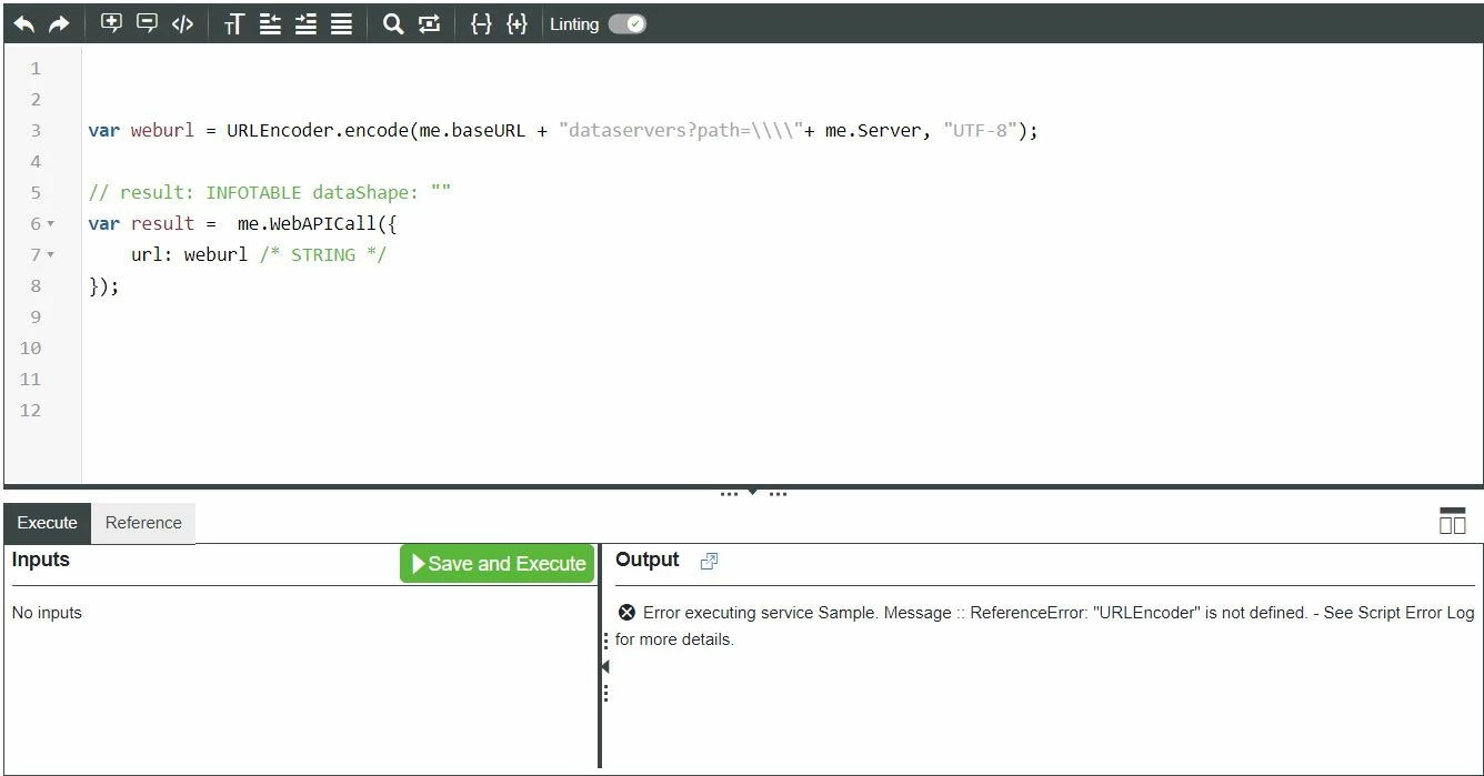

I am creating a service within a "Thing" and the service tries to get data from a REST API endpoint. I am using "ContentLoaderFunctions" (GetJSON) to send the GET request to the endpoint. It works well, when the URL doesn't have any special characters.
But it throws an error "llegal character in query at index 57: https://myserver/webapi/resource?path=myparameter"
As anyone faced this issue? Is there any function available to encode the URL ?

did you check the URLEncoder?
Sami
Mar 28, 2019 6:27 AM UTC
Yes. I tried to use it but it gives me error. Not sure if I am using it correctly since I am using JAVA syntax.
Mar 28, 2019 11:22 PM UTC
The platform does not accept "\" and considers it as an "Illegal Character". "?, &, -, =" works fine. I replaced "\" with "%5C" and it worked.

It’s more a workaround than a solution. Still looking for a solution if some in the community has used URLEncoder successfully to make a REST API call or any other method that encodes the URL is standard format.
