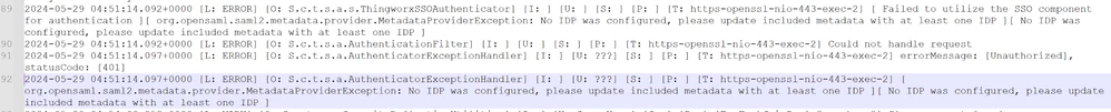

Error : No IDP was configured, please update included metadata with at least one IDP

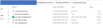

I'm start Thingworx server I'm getting below error message
I have place metadata xml from ADFS still it is throwing above error
Could anyone help me on this issue
Thanks in advance.

May 29, 2024 9:20 AM UTC
Issue got resolved.
I have added both signing and encryption certificate in sso-keystore.jks.
After removing encryption certificate from ADFS it starts to work.
