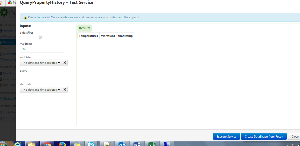

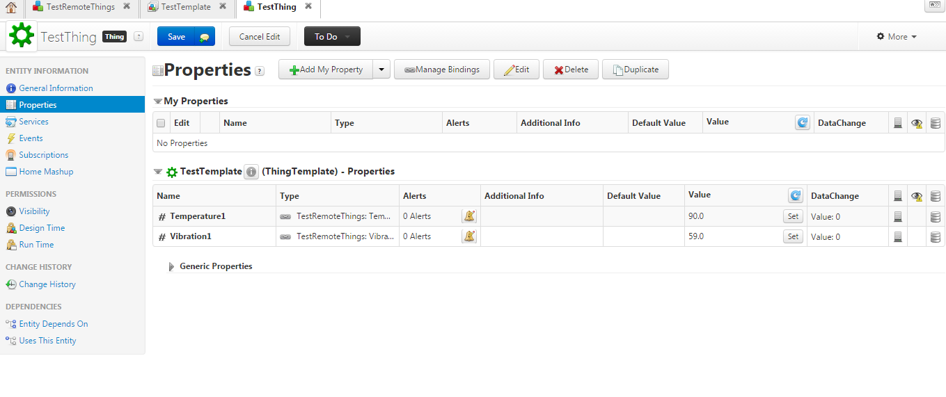

Dear Team,
I have made my thing property as logged  for to use value stream.
On refreshing on properties values are changing. But no value get logged.
In application log getting error : Error notifying things of propertyBinding changes on activate: TestThing property Temperature1

    Just a dumb question, did you set a ValueStream on the Thing?

    This is related to a Local or Remote Binding, when you do a property write this property write propagates to the Local/RemoteBinding and if it fails to write neither it writes on the Thing's property.
