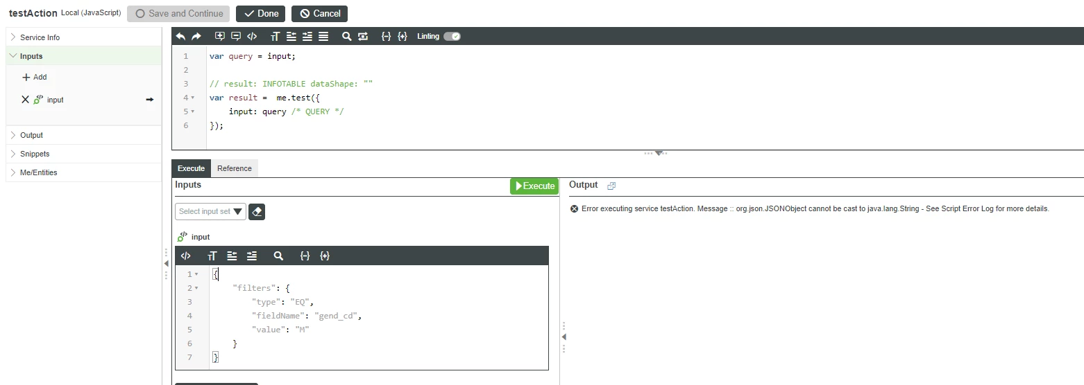

in Thing, I made two Services(SQL Query Service, Local Javascript Service).
(attach the photo.)

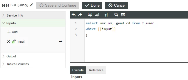

1. SQL Query Service have a parameter that is query type. (Service Name : test)
select usr_nm, gend_cd from t_user
where [[input]]
2. Local Javascript Service uses first one. (Service Name : testAction)
var query = input;
// result: INFOTABLE dataShape: ""
var result = me.test({
   input: query /* QUERY */
3. I execute second one with this parameter.
   "filters": {
      "type": "EQ",
      "fieldName": "gend_cd",
      "value": "M"
But I get an error. ( Error executing service testAction. Message :: org.json.JSONObject cannot be cast to java.lang.String - See Script Error Log for more details.)

It looks like it is going through some conversion problems
1. if you directly do
var query = {
   "filters": {
      "type": "EQ",
      "value": "M"
it works?
You could try:
var query = JSON.parse(input);
EUNJY1-VisitorAuthor
I tried but it didn't work.
I think I should learn more about conversion problems.
