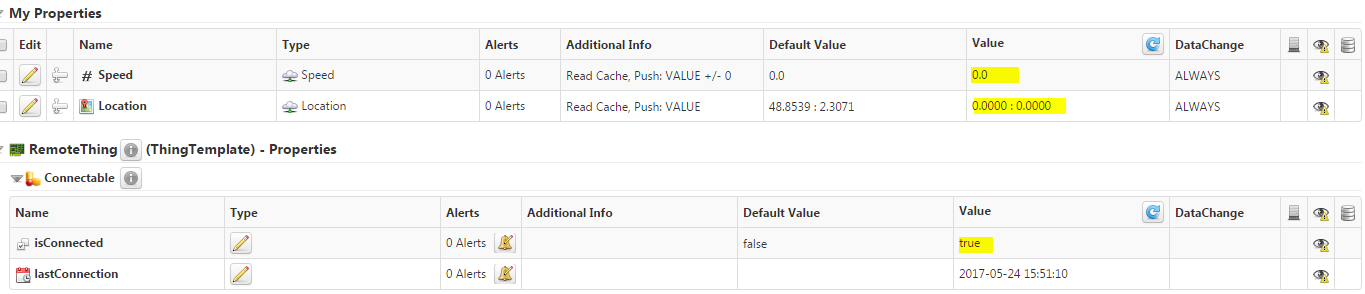

Dear people,
I have a similar issue with the wsjavatruckstart.bat.
The remote thing is connected but the zero value is always generated for Speed and Location.
Here is the message I got from batch logs :
Error Processing Scan Request for [RemoteTruck] : For input string: "54,46"
Error Processing Scan Request for [RemoteTruck] : For input string: "68,49"
My TrainingConfig.json :
    "ServerLocation": "127.0.0.1",
    "Port": 80,
    "AppKey": "1c6d618d-61a7-4b29-a565-9c8ac01d6208",
    "Security": false,
    "RemoteRepo": "/ThingworxRemoteRepository"
Thanks for your assist.
Chan

May 24, 2017
Chan could you please share the full EMS log also you'll need to be careful since you are reading from Server cache so if the EDGE properties are not set correctly server may never get the values updated. And as it seem with the scan request it's not able to push the data.
Therefore please check for the detailed log from EMS and the ThingWorx's application log. Can you also share them here?

Error Processing Scan Request for [RemoteTruck] : For input string: "56,68"
16:45:10.478 [NettyClient-NIO-1] DEBUG c.t.c.c.c.n.ThingworxClientConnectionHand
ler - [ClientHandler: 1695560218] Client has been idle, sending websocket ping..
16:45:10.480 [NettyClient-NIO-1] DEBUG i.n.h.c.h.w.WebSocket08FrameEncoder - Enc
oding WebSocket Frame opCode=9 length=0
16:45:10.483 [NettyClient-NIO-1] DEBUG i.n.h.c.h.w.WebSocket08FrameDecoder - Dec
oding WebSocket Frame opCode=10
16:45:10.486 [NettyClient-NIO-1] DEBUG i.n.h.c.h.w.WebSocket08FrameDecoder - Dec
oding WebSocket Frame length=0
Error Processing Scan Request for [RemoteTruck] : For input string: "65,7"
16:45:25.763 [Client-EndpointMonitor-1] DEBUG c.t.c.c.e.m.CommunicationEndpointM
onitorTask - CommunicationEndpoint Monitor - checking for disconnected endpoints
cnguyen111-VisitorAuthor
May 29, 2017
Do you have any advice to resolve this issue ?
Many thanks.
Chan
