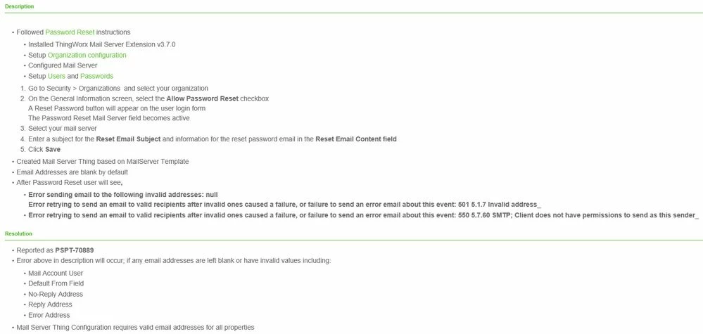

Please check if article CS341590  is useful to this issue.

Normally we create a thing that extends MailServer, so do you check these configurations(Mail Account User,Default From Field,No-Reply Address,Reply Address,Error Address) of this thing instead of the MailServer template?
