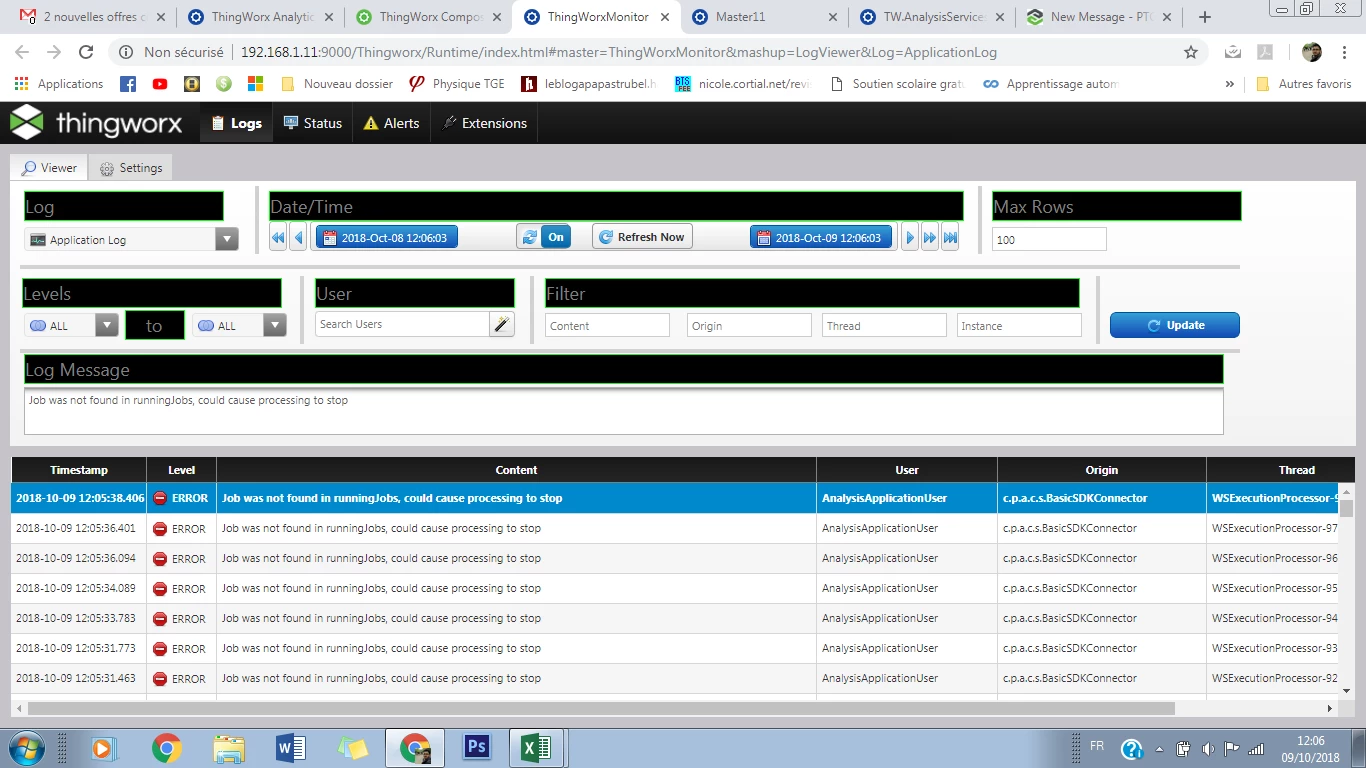

Error using Analysis Events : Job was not found in runningJobs, could cause processing to stop
I have created and published an analytics predictive model and configured an analysis event. Now everytime the event is triggered i keep getting this error on the application log : "Job was not found in runningJobs, could cause processing to stop". although the job is finished and i am getting results in the property i mapped in the results on the Analysis Event.
Best Regards.
Here are some screenshots.

Oct 9, 2018 12:36 PM UTC
Hi
This seems similar to the issue described at https://www.ptc.com/en/support/article?n=CS291235 .
Could you confirm which version of ThingWorx you are using and if you are using ThingPredictor or AnlyticsServerConnector (if using release 8.3)

csadouq1-VisitorAuthor
Oct 9, 2018 1:28 PM UTC
My Thingworx Foundation release is : ThingWorx 8.2.0-b278
and i am using Analytics Server Version : .2.040101
and yes i am workin witg tge ThingPredictorConnector
Thanks.
cmorfin19-TanzaniteAnswer
Oct 9, 2018 2:12 PM UTC
Hi
Ok thank you, in this case you fall into the issue described in the article I sent earlier.
The error messages can be ignored.
Those are gone in release 8.3 when using the new AnalyticsServerConnector.
Kind regards
