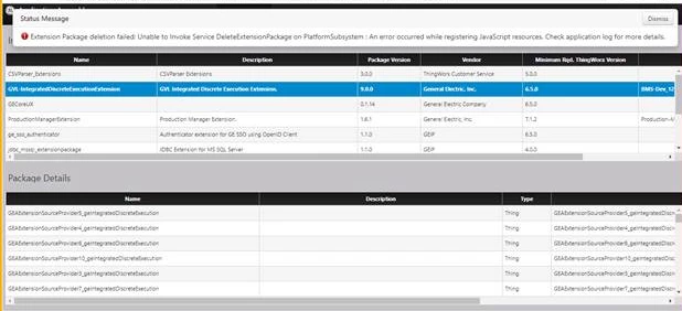

I am facing an error when trying to delete an extension. I have deleted the dependencies but getting error as below when deleting the extension.
Unable to Invoke Service DeleteExtensionPackage on PlatformSubsystem: An error occurred while registering javascript resources. Attached the error screenshot.I haven't found much information from the log. Can anyone please help on resolving this.

I cannot see much in the screenshot you attached.
But i recommend to follow the solution from this article: https://www.ptc.com/en/support/article/CS232209
Also, try to restart Tomcat, maybe there is a caching issue.

We have tried tomcat restart but it didn’t work. The solution in the other article is when Extension is deleted and some entities are not deleted causing issues during re-import. But here we are getting an error while deleting the Extension itself which is not deleted.

Please check extension reference from model_index, extensions and extension_package tables in the database.
If you can identify your extension, you can delete manually the rows from tables.
Also, check if you have ghost entities on your system.
