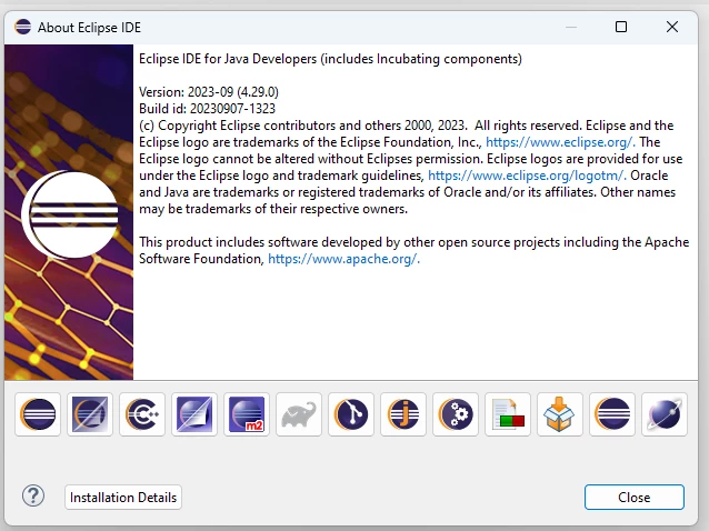

When adding the repository for the extension Eclipse plugin I receive the error in the attached pictures.
From what I understand, there are jar files in the plugin zip.
What is going on?
I have tried the current and former thingworx specific versions of the plugin without success.
Look in the attached pictures for version of the IDE, as well as the error messages.

Why are you trying to load in Eclipse the ThingWorxExtension SDK itself?
You should load the Eclipse Plugin for ThingWorx Extensions.
Latest version is available under the 9.3 Release, the last item at the bottom: "Eclipse Plugin for ThingWorx Extensions".
