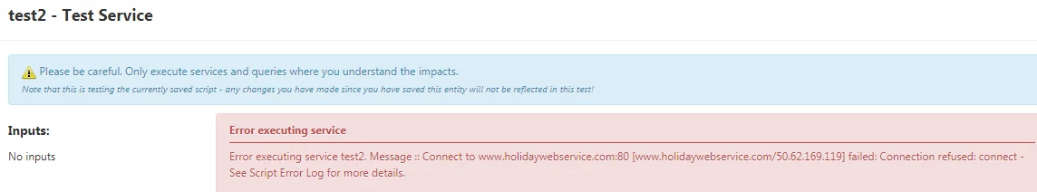

Error while consuming web-service: Connection refuse: connect
While consuming web service which returns XML, I am getting below error:connection refuse.PNG
Application log:
[context: com.thingworx.webservices.context.HttpExecutionContext@4d1285e][message: Execution error in service script [test2] :: Connect to www.holidaywebservice.com:80 [www.holidaywebservice.com/50.62.169.119] failed: Connection refused: connect]
Service Code:

url: "http://www.holidaywebservice.com/HolidayService_v2/HolidayService2.asmx/GetCountriesAvailable?CountryCode=Canada" /* STRING */,

I am using TWX 8.2.1, any suggestion?

It says Connection refused, did you try this with something like Postman and did it work with Postman?
Connection Refused probably means you aren't calling the right end point or it doesn't like where the call is coming from.
Nov 23, 2018 10:50 AM UTC
Its working with postman and soap UI. But in thingworx whatever url I give it says refuced to connect except localhost.
Do we have node js plugin for thingworx.
Nov 23, 2018 12:41 PM UTC
I've tested on my side and it works, I think that you have a problem with your server which isn't allowing outgoing communications (maybe you ha firewall rule or alike)
