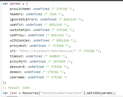

i tried to access this url http://localhost:5555/Devices/
to get json response data but  I am getting below error
 Error executing service Message :: Connect to localhost:5555 [localhost/127.0.0.1] failed: Connection refused (Connection refused) - See Script Error Log for more details.
but i can access this url with Postman and get response
service:
thanks in advance
Best answer by VladimirRosu_116627
You are using localhost as the hostname in both cases. So, is your ThingWorx server installed in the same machine (not VM) as the one from which you're doing the Postman call ?

Hi @Nour4.
Are you passing some credentials in the Postman call that you're not able to pass when accessing the url directly?  Is it possible that you have a firewall rule at the app level that is allowing Postman to succeed?
Regards.
--Sharon
July 16, 2020
