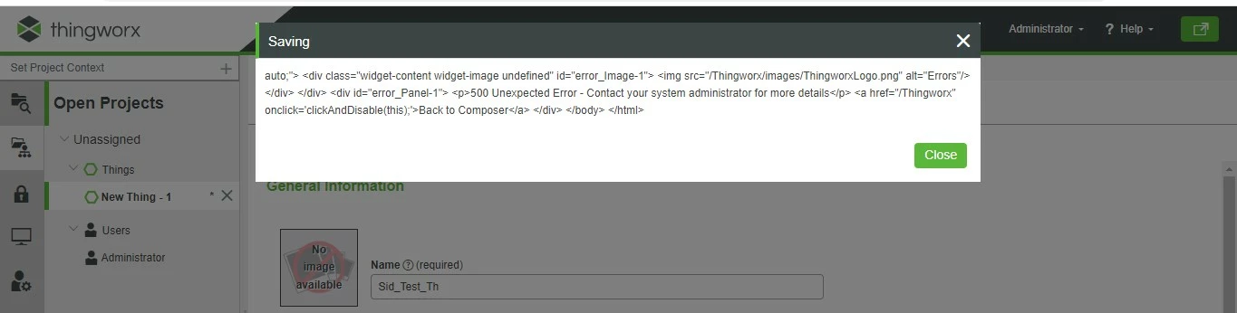

I have recently installed Thingworx on my local machine, I am getting error when I am creating any new entity and saving it.
Error on Thingworx Composer  :
auto;"> <div class="widget-content widget-image undefined" id="error_Image-1"> <img src="/Thingworx/images/ThingworxLogo.png" alt="Errors"/> </div> </div> <div id="error_Panel-1"> <p>500 Unexpected Error - Contact your system administrator for more details</p> <a href="/Thingworx" onclick='clickAndDisable(this);'>Back to Composer</a> </div> </body> </html>
Error in Application Logs :
[L: ERROR] [O: c.t.s.a.AuthenticationFilter] [I: ] [U: ???] [S: ] [P: ] [T: http-nio-8080-exec-8] org/apache/tomcat/util/http/Parameters$FailReason
Error in Error Logs :
[L: ERROR] [O: E.c.q.l.c.Logger] [I: ] [U: ???] [S: ] [P: ] [T: http-nio-8080-exec-9] org/apache/tomcat/util/http/Parameters$FailReason
Thingworx Details are as under :
Version : ThingWorx 8.5.14-b854
Kindly, help me troubleshoot this error. Attaching screenshot of composer error for reference.
