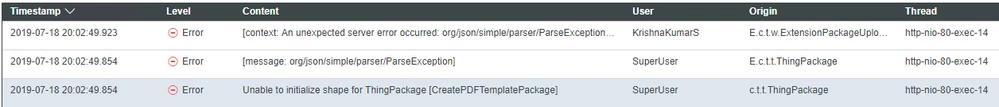

I am trying to import a custom extension ( coded in java to generate PDF files ) into Thingworx 8.4
While importing, I get the below error (see picture) and the import fails.
The same extension file, when I import in another instance of Thingworx ( on another server ), gets imported without any errors. The Thingworx version on this server is Thingworx 8.3.2-b535.
Can someone help me identify the problem?

Hello Slangley,
Apologies for the delayed update. I got the extension working. I replaced the specific Exceptions such as JSONException,DocumentException from the service class and replaced them with just "Exception" (Parent exception). Had to restart the thingworx foundation service before importing the extension again. This worked.

Hi @kkgooner.
Are both ThingWorx instances (8.4 and 8.3.2) configured the same in regard to other extensions that are installed?  Do you get the same error if importing under the Administrator login?
It may be necessary for you to provide your custom extension for us to determine the cause.

It appears we may have to engage with R&D to determine why this extension is not importing under ThingWorx 8.4.  However, before doing so, please provide your platform-settings.json file so we can validate the import policy you have set.

kkgooner1-VisitorAuthorAnswer
August 19, 2019
Hello Slangley,
