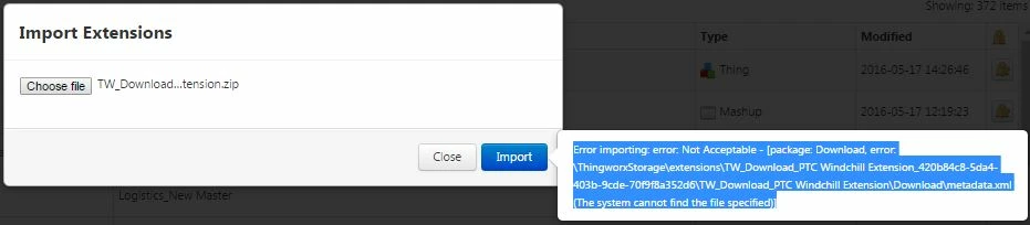

I am trying to import TW_Download_PTC Windchill Extension in Thingworx Composer version 6.0, but I am returning with error as "Error importing: error: Not Acceptable - [package: Download, error: \ThingworxStorage\extensions\TW_Download_PTC Windchill Extension_420b84c8-5da4-403b-9cde-70f9f8a352d6\TW_Download_PTC Windchill Extension\Download\metadata.xml (The system cannot find the file specified)]" .
Please let me know if this is due to composer version or any other issue?

Try unzipping your download first, then import. Recently the Marketplace underwent a change that wrapped all downloads with another layer of zip.

Tried unzipping and also importing each extensions inside .zip download folder(10.1-M040_WCTWXExtension-03.04,10.2-M030-CPS01_WCTWXExtension-03.07,ptc-windchill-extension-1.2.1-01), but still error importing.
May 17, 2016
You should read the README.txt inside the Download.zip. It also provides a link to Windchill's document about this extension and its use.
Not everything in the download are ThingWorx Extensions. The one you want to import into ThingWorx is "ptc-windchill-extension-1.2.1-01.zip".
The other zips are patches for Windchill. Looks like there is a mashup XML that you can import into ThingWorx as well by using "Import from File".

I noticed that minimum Thingworx version must be 6.5. I am using 6.0.3 and hence not importing.
