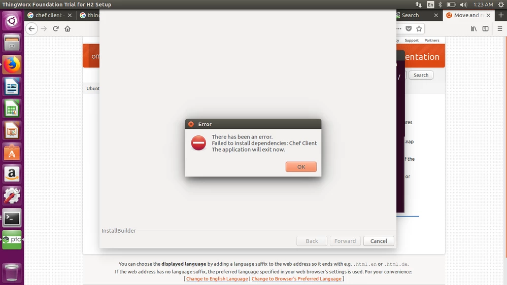

Error while installing ThingWorx 8.5 trial version
I am getting following error while installing thingworx 8.5 trial version Screenshot from 2019-11-24 01-23-21.png

Hi @cgoma.
We have confirmed that Ubuntu is NOT a supported platform for the trial versions.  We will be pursuing an update on the downloads page to advise this information.

November 26, 2019
What are the install logs saying?
Find them in <Thingworx_install folder>/installer/logs

No logs are getting generated at installation directory.
The error which I received is already attached as screenshot earlier.

Hi @cgoma.
We just updated the trials on Friday.  Are you running the latest (ThingWorx 8.5)?  Which version of Windows are you running?
Did you run the installer more than once?  If so, you will manually need to remove the artifacts that were left by the previous installation.  Also, if the installation still fails on your next attempt, search for the logs BEFORE clicking OK on the error dialog.  Once you click OK, cleanup will be performed removing the logs.

I have downloaded this trial version on 24 Nov.(i.e. on Sunday).
I ran the thingworx 8.5 installer only once. I am trying to install thingworx 8.5 on ubuntu 16.
Please let me know if you have the exact steps which I should be following while installing the thingworx 8.5.
Also how to exactly configure java as when I was working with thingworx 8.4 it was working fine with java openjdk. But when I started using oracle java the thingworx 8.4 stopped working. I am attaching the logs for twx 8.4 version but for 8.5 version the log itself are not getting generated.
