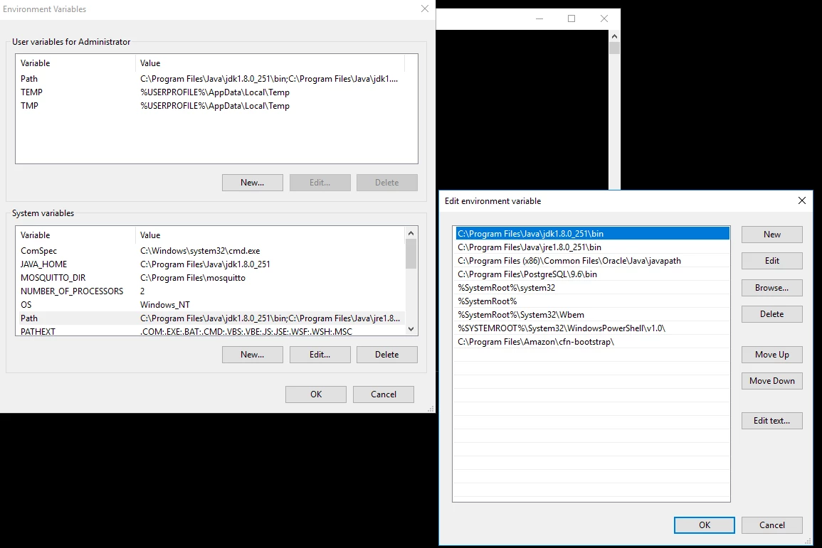

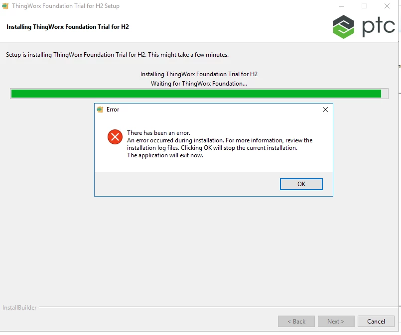

I'm not able to install thingworx 9.0 version 90days trail fro windows , facing below error,
I have attached environment variable image and all log file please suggest where I was wrong.
Dec 4, 2020 12:14 PM UTC
I have reinstall my system OS  it is now working and successfully installed, But I thing this is not right way to clean your OS and reinstall again while facing such Thingworx installation issue.
It must have another way to install without doing unistalled your system OS.

Hi @DT_9697337.
Here are some things to check:
  • You need to put JAVA_HOME under System environment variables
  • Do you have multiple version of Java installed?  I see this on line 18 of the bitrock installer log:
[16:16:39] - HOST_JAVA_HOME path: C:\PROGRA~1\Java\JDK18~1.0_2\jre...
  • Are you running the installer as Administrator?
Please let us know if you continue to have issues.

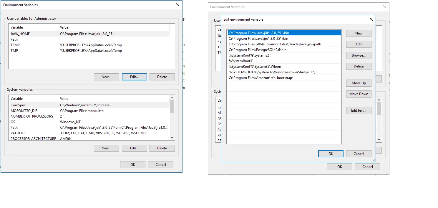

Nov 19, 2020 8:52 AM UTC
  • You need to put JAVA_HOME under System environment variablesI did this oath and tried but it gives me same error
  • Do you have multiple version of Java installed?  I see this on line 18 of the bitrock installer log:I dont have more java installed on my system, only one i have installed jdk 1.8.0_251, Also i have attached my environment variable setting image please check.
  • Are you running the installer as Administrator?Yes, I tried with run as Administrator but it gives me same error.
Please suggest me the right way i'm trying from last 4 days.
