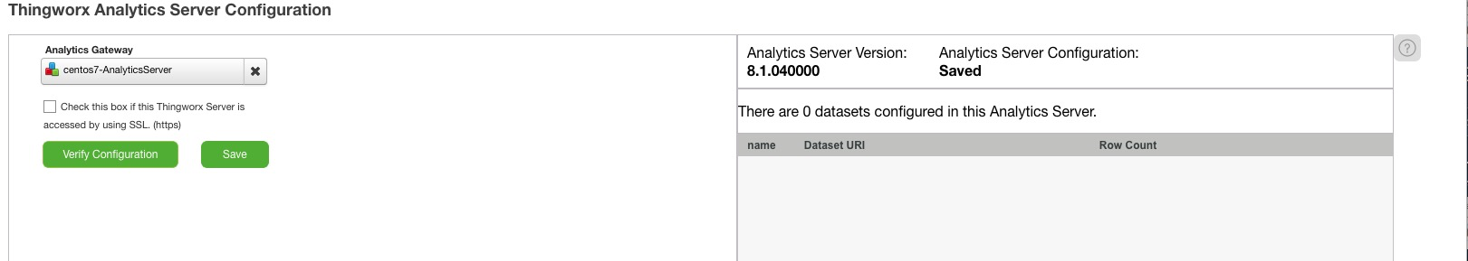

Analytics Server 8.1 ( Docker install on linux)

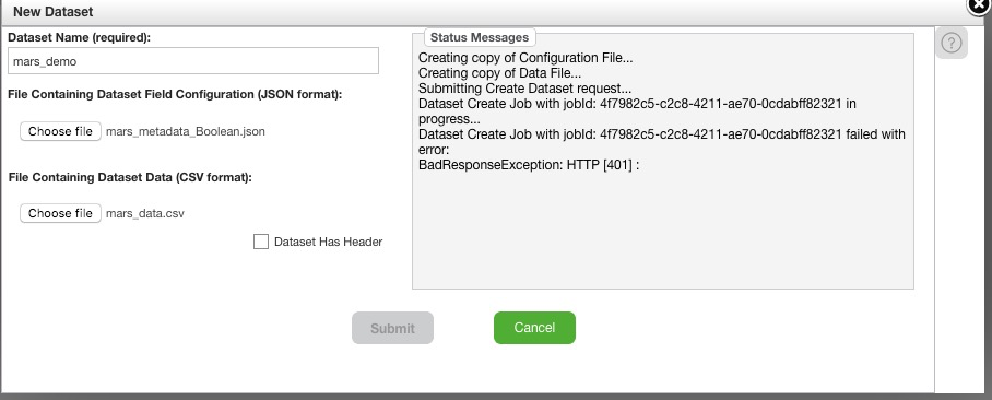

The problem i face is when i am trying to build a dataset i get and error with 401.

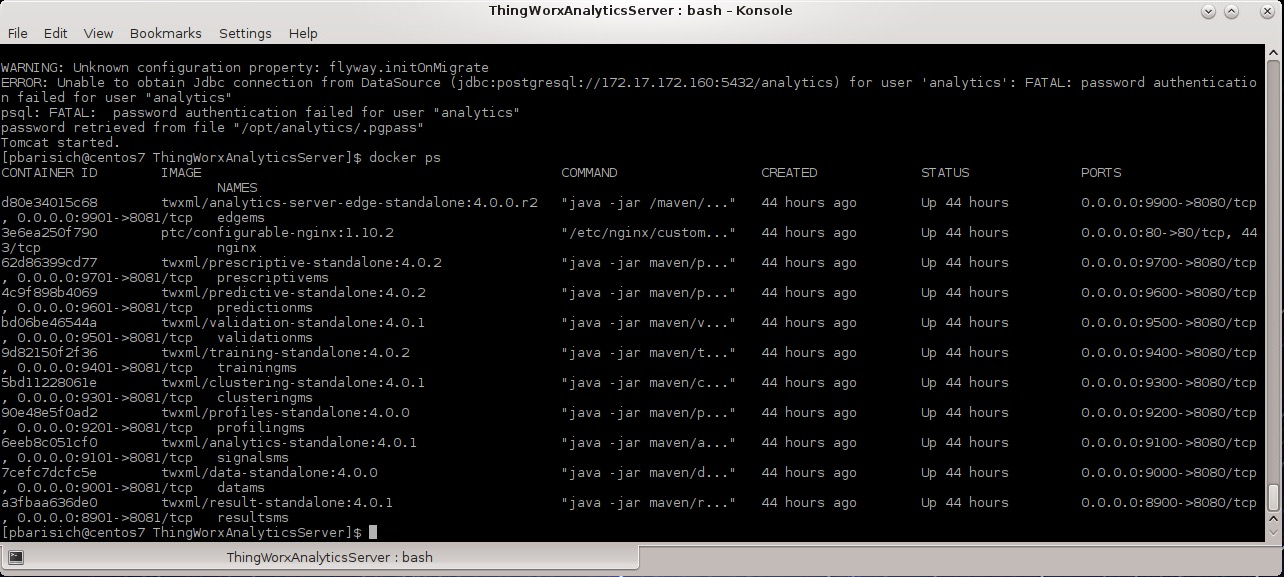

here's a snapshot of the docker ps services running

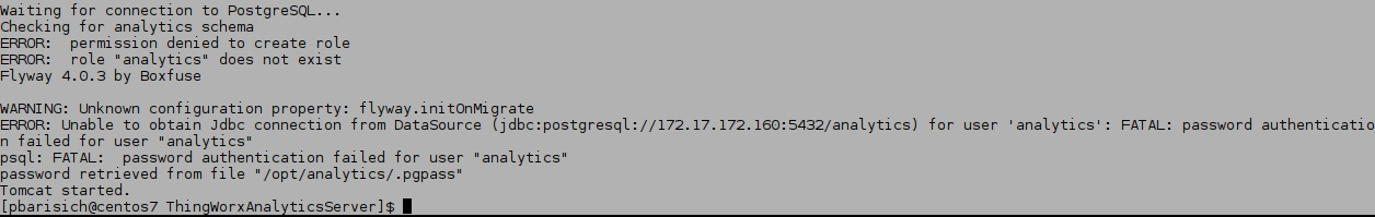

I am not sure why but analytics services are trying to connect to a PostgreSQL DB via analytics users. I dont understand why , and there was no prerequisites on documentation for postgresql DB on the docker install.

The command i used was from the Analytics Builder GUI. It happened when i tried to load a dataset as described in Picture 1 above.

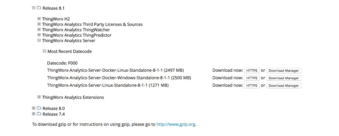

Here a screen grab of our downloadable area within PTC
Hope you can read this but it seems to indicate "Analytics Server Docker linux Standalone 8.1 version" , so not really sure about the comment with regards to versions. Could be wrong im pretty new to all this .
Yes i had previously run Analytics Server 8.0 on this linux box but thought i had remove everything , it was a linux standalone version . I had thought of this issue but the check which docker containers were running and the URL that activate.

Also forgot to mention the exact postgresql error was found by loggin onto the linux box and running the command "docker logs analytics" . and the time stamps matched up with my actions in the Analytics Builder

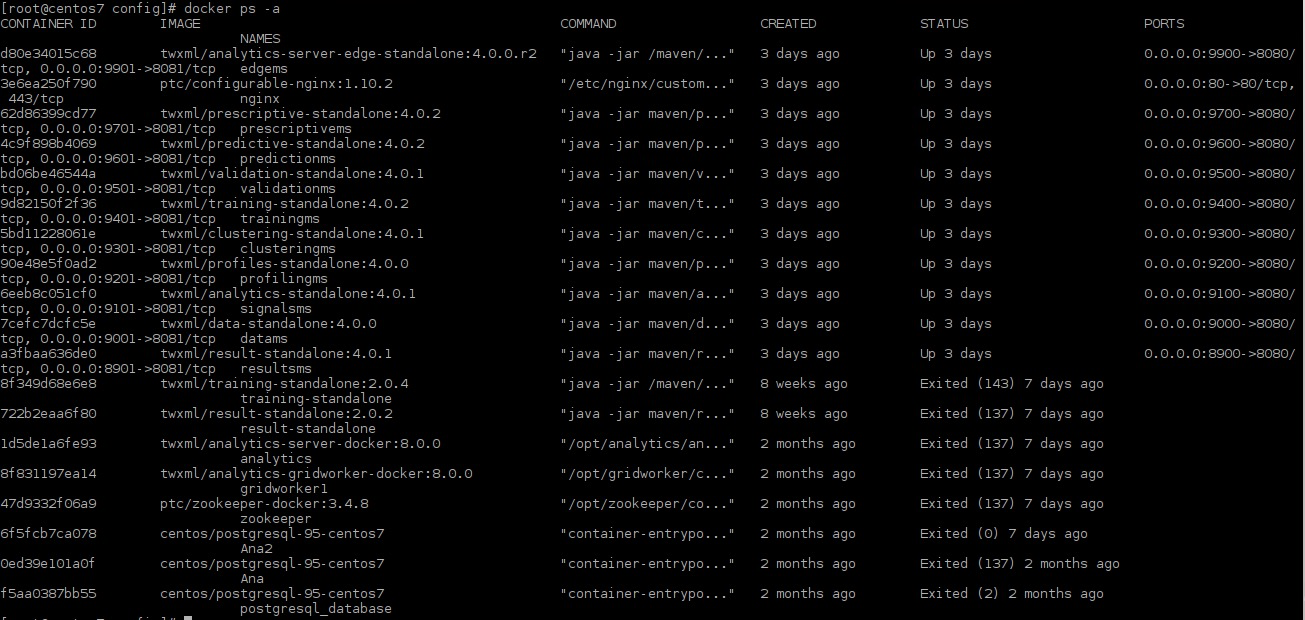

It seems that you do have some remain of an 8.0 version.
Could you post the output of docker ps -a ?
docker logs analytics is not relevant here. The analytics container is not part of 8.1, it used though to exist in 8.0.
We can see in your output of docker ps in the initial post that there is in fact no analytics container running, which is normal.
The error we have is to be found in the datams.log:
com.thingworx.analytics.ccc.platform.http.BadResponseException: HTTP [401]
Causing: java.lang.RuntimeException: java.io.IOException: Unable to initialize FileRepository
the 401 means authentication failed, so it is likely that you have an incorrect appkey in the Analytics config file(s).

Heres a snapshot of docker ps -a
