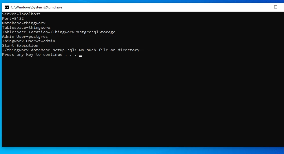

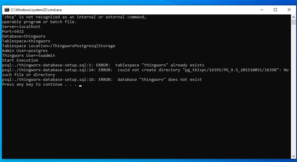

Hi
I have installed Postgresql in my local pc and i  am getting the following error in ThingworxPostgresqlDBsetup.bat file and thingworxPostgresSchemaSetup.bat file
Can anyone guide me to rectify this error

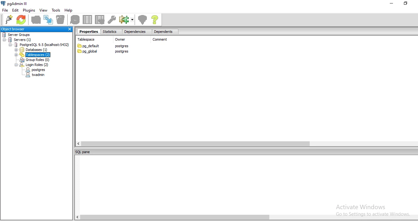

September 30, 2019
1. Delete any tablespace created in the location ThingworxBackupStorage; check also in Postgres database to NOT have any datbase called "thingworx" or tabespace called "thingworx"; if any just delete them from database.
2. Run ThingworxPostgresqlDBsetup.bat  with tablespace location  C:/<path_to_location> or C://<path_to_location>
3. After successful ThingworxPostgresqlDBsetup.bat, run also thingworxPostgresSchemaSetup.bat
Best regards,
Raluca Edu
Peter_Raj1-VisitorAuthor
September 30, 2019
I followed your steps but I dont find Thingworx on any of the database and Tablespaces
but still the error apears again
raluca_edu
September 30, 2019
Are you executing the script from the path where the script resides?
If not, I recommend to change directory to that path and execute the script again. Also, you need to have psql in environment vars.
Best regards,
