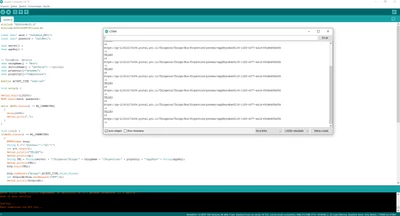

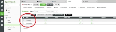

Hi, Team!
  I work with these sketch but the TW don´t receive any data.
  Follow two printscreens.
#include "ESP8266WiFi.h"
#include<ESP8266HTTPClient.h>
const char* ssid = "InfoAxis_NET1";
const char* password = "InfoNet1";
char server[] = "xxxx";
char appKey[] = "xxxx";
// ThingWorx details
char thingName[] = "Box";
char serviceName[] = "setValue"; //optional
char property1[]="pressao";
char property2[]="temperatura";
#define ACCEPT_TYPE "text/csv"
void setup() {
Serial.begin(115200);
WiFi.begin(ssid, password);
while (WiFi.status() != WL_CONNECTED)
delay(1000);
Serial.print(".");
void loop() {
if(WiFi.status() == WL_CONNECTED)
HTTPClient http;
String t ="{\"pressao\":\"40\"}";
int a=t.length();
Serial.println("TELLES");
Serial.println(a);
String URL = String(server) + "/Thingworx/Things/" + thingName + "/Properties/" + property1 + "?appKey=" + String(appKey);
Serial.println(URL);
http.begin(URL);
http.addHeader("Accept",ACCEPT_TYPE,false,false);
int httpcode=http.sendRequest("PUT",t);
Serial.println(httpcode);
if(httpcode > 0)
String payload = http.getString();
Serial.println(payload);
String t1="{\"temperatura\":\"56\"}";
int a1=t1.length();
Serial.println(a1);
String URL = String(server) + "/Thingworx/Things/" + thingName +"/Properties/" + property2 + "?appKey=" + String(appKey);
http.begin(URL);
http.addHeader("Content-Type","application/json",false,false);
int httpcode=http.sendRequest("PUT",t1);
if(httpcode > 0)
http.end();
delay(1000);
Perhaps I´m skipping some steps.
Regards.
Telles.

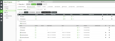

Unfortunately, I have to chance the microcontroller to ESP32 and solved the problem!

I see a couple issues:
1. You are not using the HTTPS library. This library is required for making https connections to the free trial servers
2. You are sending a string value in  your JSON to a Number type property

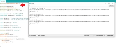

Hi, Rick.
Now I´m using these libs:
#include <Arduino.h>
#include <ESP8266WiFi.h>
#include <ESP8266HTTPClient.h>
#include <ArduinoHttpClient.h>
#include <WiFiClientSecureBearSSL.h>
Follow printscreen, and changed the Properties to String.
But the TW still off.
Maybe I need a specicly library. Do you any URL for it?
Regards.
Telles.

Did you ever get the code here to work:
https://developer.thingworx.com/en/resources/guides/connect-adafruit-feather/set-arduino-ide-and-board
If that code does not work, you will not be able to get your code to work.
It looks like you are missing these lines:
std::unique_ptr<BearSSL::WiFiClientSecure>client(new BearSSL::WiFiClientSecure);
client->setInsecure();
https.begin(*client,URL);
