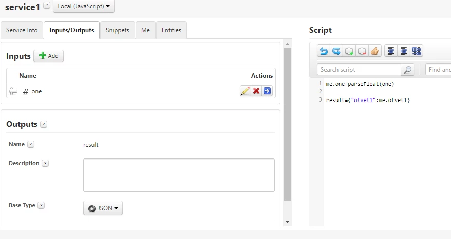

Hi everyone, i chose Thingworx platfom for my study project. In general, there is should be robot which sends and also recieves data from Thingworx mashup via Nodemcu ESP8266.
I followed this tutorial, but it didnt work for me https://developer.thingworx.com/en/resources/guides/connect-adafruit-feather
I tried to launch it on next 2 platforms with different UI for some reason
https://ptcu-thingworx83-fundamentals.portal.ptc.io/Thingworx/Composer
and
https://academic.cloud.thingworx.com/Thingworx/Composer/
Got only some messages from port monitor like state: 0 -> 2 (b0)
I actually confused about this, so is it possible to connect my ESP to one of these platforms and what the difference here? Can anyone help with some advice or even working example? Actually some simple operation of sending any number from ESP to Thing property would be enough for me.
Thanks a lot in advance.

The guide you mentioned shows how to use ThingWorx REST API from a limited resource device. Before adding the complication of hardware, confirm you are able to use the REST API from a PC:
https://developer.thingworx.com/en/resources/guides/thingworx-rest-api-quickstart/use-rest-api-get-latest-property-value
Some common things to check:
Do you have the correct URL and port?
Do you have a valid, un-expired appKey?
Does the Thing exist on the ThingWorx platform?
Does the Thing you are attempting to use have the property you are trying to access?

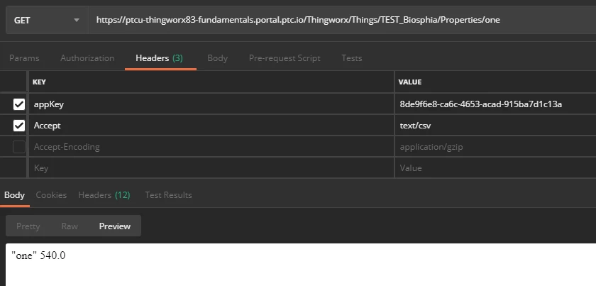

Thanks for your response, Postman is working fine and recieves data from property succesfully according to screenshot, but ESP returns "Error on sending GET Request: -1".I tried to make some simple GET request to property "one" as well.

Solved! Some sample code for future researchers, you want to change wifi parameters and your Thingworx platform parameters. Here you just sending ++number to the first property (one )and getting another from the second (otvet1) they both have type number. Contents of service u can find in the screenshot below.
