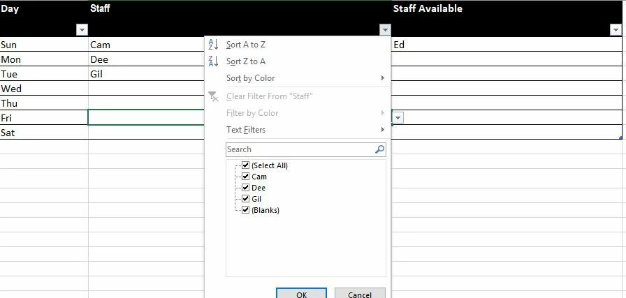

I wanted to use excel like filter using Thingworx advanced grid using which I can filter data using two or more column.
Also I am attaching the screenshot of the screen which I need to implement using thingworx.
Please let me know if it is possible to do the same.
January 6, 2020
For filtering Advanced Grids, you need to use Queries. Have a look at this support page which explains how you can use queries through JSON-based services.
