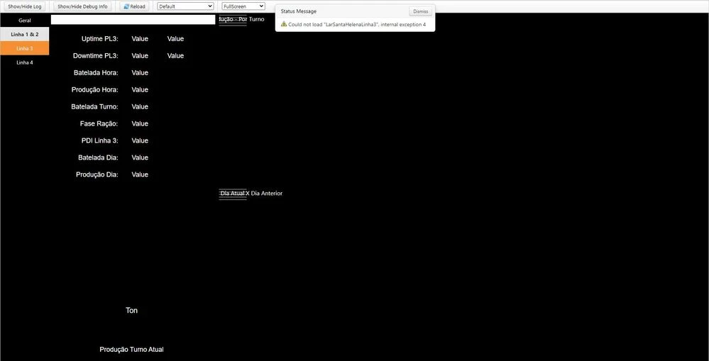

Hi everyone,
When I try to change to navigate to another dashboard through of my menu happens it:
"Could not load "Mashup Name", internal exception 4"
Can someone help me?

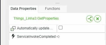

I was able to stop this issue.
When I disabled the "automatically update" it worked well.
But I do not know to explain the reason.

Hi @leokeinsfeld,
I believe it is related to the mechanism of GetProperties() service, which will automatically be updated/triggered whenever the properties changes if that box is checked.
I guess you may want to check this:
GetProperties service used in Mashups leads to request overhead in ThingWorx

Thanks for your answer.
I disabled the check from service getproperties and changed it for autorefresh widget.
It is working well.
