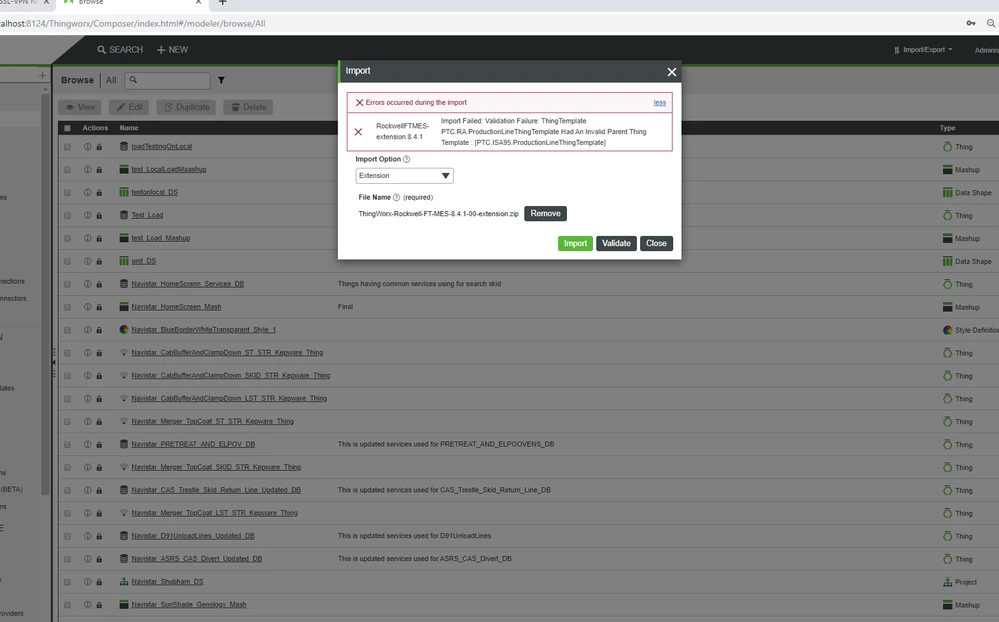

Hi Everyone,
I have downloaded "MED-61283-CD-084_SP1_ThingWorx-Rockwell-FT-MES-8-4-1-Extension-Bundle" Extension and while i am trying to import it on 8.4 thingworx version. it showing me an below exception.
Also for this same  Extension there is no document present on site.
could you  please help me on this.

@RockLala Are you seeing any errors in the application.log and/or in ErrorLog.log?
Please refer to this article for more information.
Also, take a look at this community post.

September 20, 2019
Thanks For the replay...
But in Platform setting file I already did the required changes and for other extension it working fine means  it got import successfully... but only this Rockwell extension is not getting imported successfully.
Here I also attached my application log file.
Thanks In Advance.....

September 23, 2019
Please check this file: https://www.ptc.com/support/-/media/AC75D6E640C74B5B9958341B3983423C.pdf?sc_lang=en
Probably you will need also Thingworx Flow before importing the extension.
In log file, you can see also this warning:
WARNING: Attempting to import an entity that contains workflows when Platform orchestration functionality is disabled. Importing the workflows may cause errors when Orchestration functionality is enabled.
