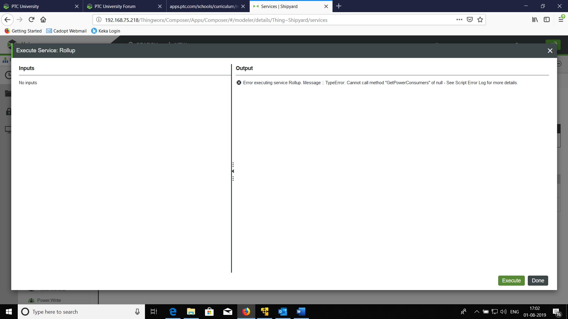

@anitha_s_kumar You can refer more information on visibility permissions here . If the issue is not resolved, can you share the script error log for more details?
22-Sapphire I
August 1, 2019
Looks like perhaps the context that is executing the RollUp service doesn't have visibility rights to this other service it is calling.
August 12, 2019
Thanks for the inputs .It helped me resolving the error . Yes I had to correct the visibility rights and also a small correction in the script as I was not using the demo version of Thingworx.
var sysServThingName = "PowerSystemServices" + "_" + username;
corrected the above  statement to
var sysServThingName = "PowerSystemServices";
