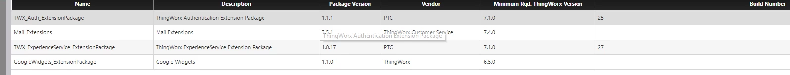

I am currently working on a Trial Thingworx Server which is included in the Thingworx Studio Trial. In the Composer of this Server I am not the Admin.
I imported the Google Maps Widget extension successfully as you can see here:

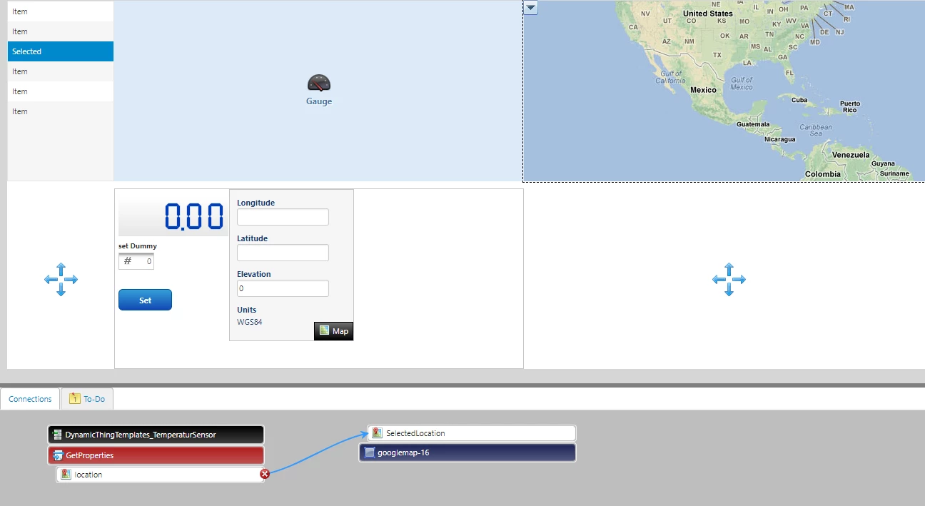

Now when I model a Mashup, I can also use the widget and it looks like this during design:

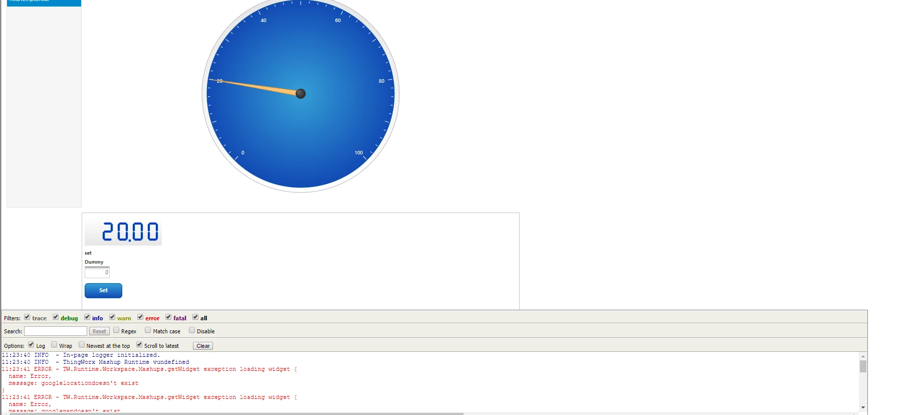

You see the map widget is displayed. But when I "View Mashup" it just does not appear and I get an error as seen here:
Error: Exception Loading widget: googlelocation does't exist
Any ideas how to cope with that?

Do you have a value set for the property named "location" that is being sent to the Google Maps widget?
Did you enter your developer key into the Google Maps widget before you uploaded the widget?
There are instructions here:
https://developer.thingworx.com/resources/guides/google-map-widget-how
for using the Google maps widget

Unfortunately it did not work for me. I requested and API Key and changed the metadata.xml liked described but still nothing is showing.
Its realy strange because i used exactly the same aproach on my local Thingworx Server and there it worked
