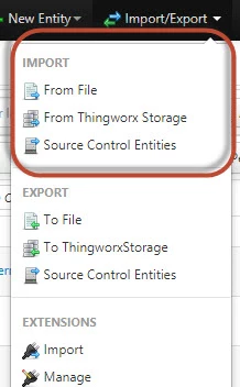

    August 9, 2018
    based on your login account for the hosted instance I think you should be able to import using the Import function
    If in case this is not visible for you, you may want to reach out to ThingWorx Administrator to allow this for your profile.
