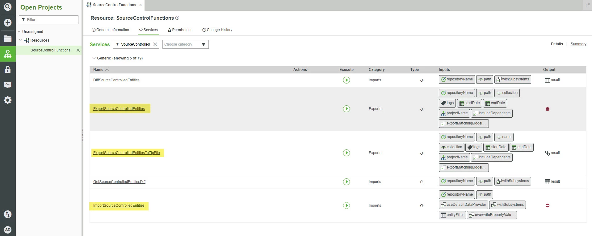

Hi @ranjank,
Here are some out-the-box APIs that can be used to import and export entities : ExportSourceControlledEntities, ExportSourceControlledEntitiesToZipFile, ImportSourceControlledEntities. They are available under the SourceControlFucntions resource.
Please refer also to SourceControlFunctions.

Hi @ranjank,

Hi @ranjank,
The APIs mentioned in my previous email are the ones available in ThingWorx. They do import/export from/to XML only though.
Note that you can also export/import using REST API : Manually Importing and Exporting.
