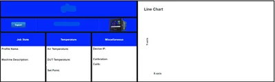

Exporting CSV files from Line Chart
Hi everyone, I am currently trying to export data to CSV in which I have collected in my LineChart from my mashup. I have seen the following article: Solved: Re: How to Export a Custom Excel file from Thingwo... - PTC Community.
In which shows how to import CSV files but I am trying to export that data out and if its possible can is there a way to export in 30 minute intervals?
I would be exporting data from a thing in thingworx from a thing group that updates that chart if that information is helpful.
I'm using ThingWorx 9.3.5

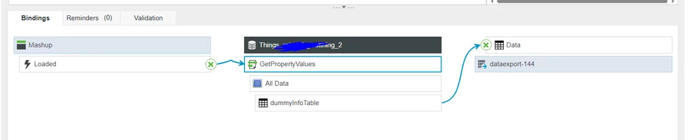

I read up on that Data Export Widget, but what is the best way to bind that?

Velkumar19-TanzaniteAnswer
Mar 20, 2024 4:41 AM UTC
Hi @VC_10938534
You can bind any InfoTable output to the Data Export widget. If you want to download Line Chart data as CSV, you can bind Line Chart data to the Data Export Widget.
