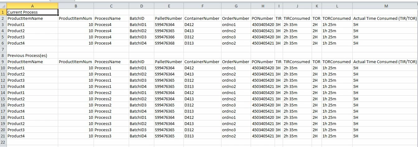

I have a requirement to Export data to CSV but need two sections in imported file.
Is there a way to achieve this using DataExport Widget? Attaching screen shot for reference.
Appreciate anyone's help in advance.

DataExport widget will export exactly what the service puts out.
So I would create a service that combines the two tables.

I tried giving infotable of infotable can we do it in any other way?
22-Sapphire I
April 16, 2019
Since you need the repeated header row, I don't think the infotable functions will help but I would just go with
var table1 = <MyFirstTable>
for each (var row in <MySecondTable>.rows) {
   table1.AddRow(row)
This may not quite work right, because you are adding a row to a table vs. a row object, so you may need  to find the proper syntax.
