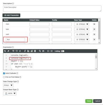

It seems that the expression can only accept 3 parameters,  the 4th and consequent parameters are not recognized.
In the attached screenshot,  console.log(thur) print nothing whatever the base type is STRING or BOOLEAN.
And the 4th parameter has a strange border .

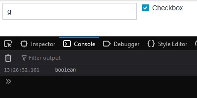

Best answer by VladimirRosu_116627
I've got the same ThingWorx version (PostgreSQL provider) in a VM, and the image box around the 4th+ item is reproduceable in Firefox as well, looks like an UI issue mostly.
The console.log works fine for those parameters though.
On the boolean side I could not reproduce though. When a Checkbox's state is bound to a boolean type input parameter, the typeof returns boolean - as seen in the console below.

Hello @seanccc
Yeah it seems as expression is used to evaluate js expressions it might take only 3 parameters. Though there is nowhere it is mentioned so let me collect some more information regarding it and I will get back to you. For your reference you can refer following link
http://support.ptc.com/help/thingworx_hc/thingworx_8_hc/en/index.html#page/ThingWorx/Help/Mashup_Builder/Functions/Expression.html

Hello @seanccc
I tried adding 4 parameters to expression and print the values over console and was able to do so.
Might be you are missing something . Can you provide more detail of your use case?

@odukiya ,
I tried again today and yes, console.log  the 4th parameter works, I have no idea why it didn't work.
But it still has some problem for data type "BOOLEAN" ,  the passed value is STRING "true" instead of true for the 4th parameter although set the data type to BOOLEAN.   Set the data type to "STRING" can be a workaround .
