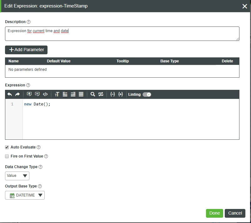

I need a Timestamp for some of my widgets but the expression does not work anymore in the updated version 8.4.
How can i evaluate the datetime in a expression ? Or do i need a service now ?

The expression you show in the attached PNG file is:  "new Date();"
try changing the expression to "result = new Date();"

Unfortunately that does'nt work either.
The Output in the Widget is "not a date..."
