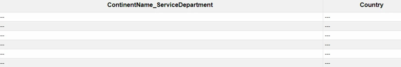

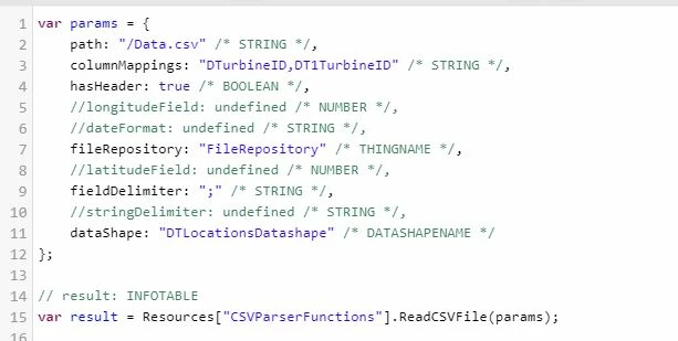

I am using the extension CSV Parser. But when I am trying to read the excel file, I was able to, but it wasn't showing anything in the table after running the service.
Attaching the result and code with the name Empty Results.jpg and Code.jpg.

Can you check again by putting below values for following parameters and try?
columnMappings: undefined
fieldDelimiter: ","

@adiku Are you seeing any errors in the logs?

Nopes, there is no error.
