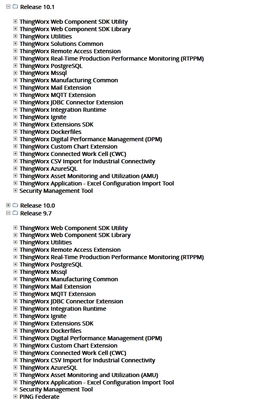

Jan 22, 2026 1:56 PM UTC
One other thing.....
Always check the PTC download site first for extensions for the relevant ThingWorx version before pursuing other options.
Regards.
--Sharon
