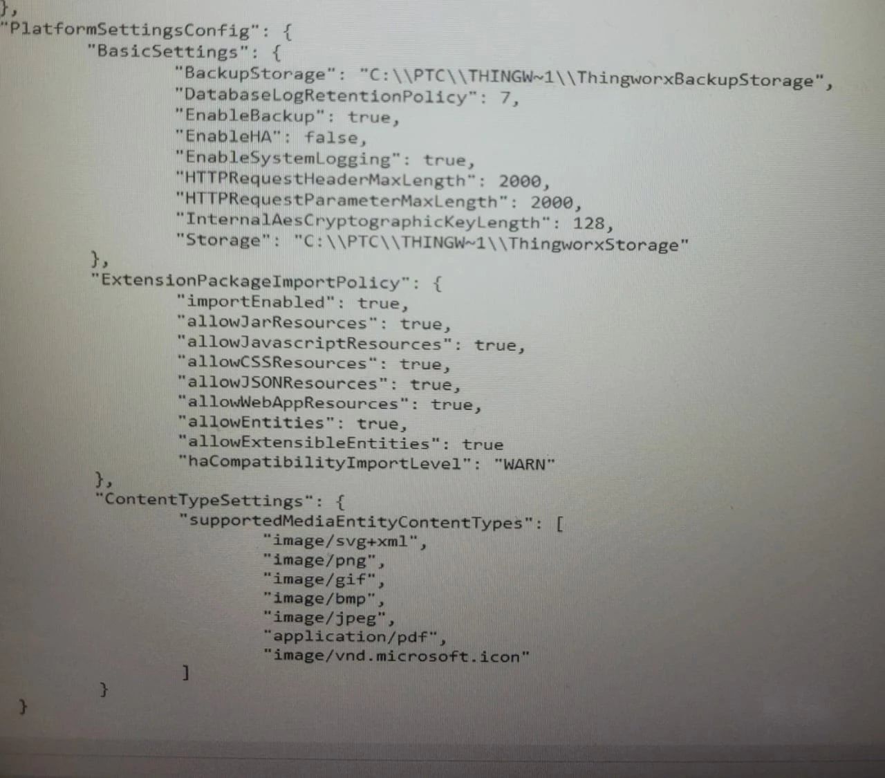

Hi Everyone,
I have update the platform-settings file stil I am facing the package import policy issue:

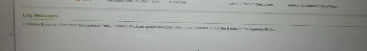

Error: Extension Exception: ExtensionPackageImportPolicy: ExtensionPackage upload attempted while import disabled. Check the ExtensionPackageImportPolicy
Can anyone help me.

For one you could restart the whole machine.
A bit more lightweight would be -if you are on Windows- to go to Services and restart the Tomcat for your ThingWorx installation.

Have you restarted the server after making the changes?

Hi @Rocko ,
Thanks for your reply.
I am new to ThingWorx can you please tell me how to restart the server.
