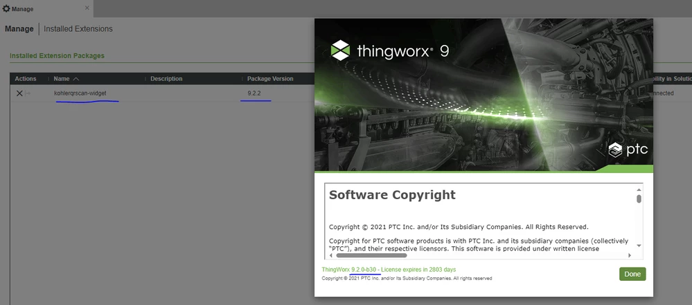

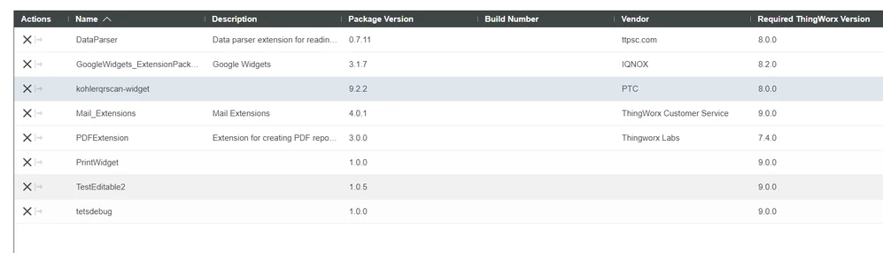

@KN_9954684  I'm able to import your extension in Thingworx 9.2.0
Try to import your extension into a different environment and check

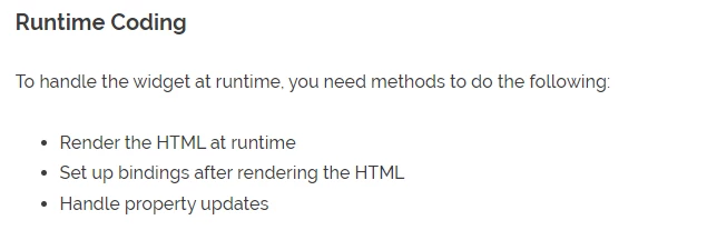

Based on your error message, some required methods are missing in your runtime.js
Please refer to this link for the complete extension development guide - Create A Mashup Widget Extension Part 1 - PTC Community
/VR

May I know your Thingworx Version.
I tried importing your extension into Thingworx 9.3.7 and it got imported without any error
