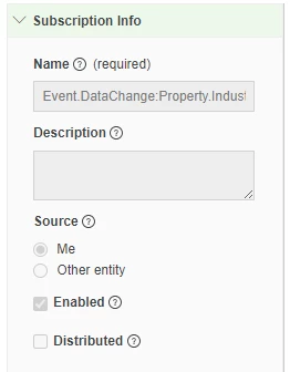

I'm developing an application using ThingWorx 9.4.0.  I used the "Package" feature of my Project entity to create a .zip file.  When trying to import into my package as an Extension into our Test/QA platform, I'm getting the following error (redacted bits in <>).
Application Log:
Extension Exception: Error parsing /files/ThingworxStorage/extensions/temp/<ProjectName>-1.1.0_<GUID>/<ProjectName>-1.1.0/Entities/ThingShapes/Entities.xml: (88, 37): cvc-complex-type.3.2.2: Attribute 'aspect.isDistributed' is not allowed to appear in element 'Subscription'.
Our Test platform is a HA cluster implementation, so it doesn't make any sense why the project is failing with the error "isDistributed is not allowed".  I verified that it wasn't a problem with this single project by creating a separate test project with a simple subscription and trying to import it to my Test system.  I got the same error.
Is this a bug in the platform or is there possibly some system configuration we missed?

The warning is generated by the lack of the haCompatible attribute that should be added in the metadata.xml at the ExtensionPackage node level. Set it to true. If the Package functionality is not doing this, then it would need to be fixed, but in the meantime you can add it manually.

I've just created in 9.4.1 a project with a ThingShape, added a ThingShape to it that contained a Subscription. I verified it contained the attribute you mentioned, but it was imported correctly.
Two questions:
1. Can you install quickly a 9.4.1 and check this behavior?
2. (Curiosity) I have a single node system, non-HA, and I don't see the "Distributable". When you create a Subscription in a ThingShape I assume you can enable "distributable", right?

About the single node system, I've noticed that single node systems do not show the "Distributed" checkbox for subscriptions while cluster systems do.  We originally had our Development platform set up as a single node.  After getting the "isDistributed" error, I tried modifying our Development system to run as a cluster and re-exporting my app to see if that would resolve the issue.  It did not.
Now that I'm writing this out, I wonder if it's something to do with the Composer checkbox being "Distributed" while the attribute in the xml is "isDistributed"?

There's no relationship between the attribute name "aspect.isDistributed" and the Composer label (as it will anyway display the text depending on your ThingWorx user locale).

I believe updating to Thingworx 9.4.1 fixed this problem however my workaround was this:
1. Extract the .zip package.
2. Open in Notepad the entities xml with the affected subscription (ZipFolder/Entities/ThingShapes/Entities.xml in my case).
3. Find the affected Subscription and delete the aspect.isDistributed="false"  line (see image). Save the file.
4. Zip the folder back up and import as extension.
As @VladimirRosu_116627 stated, "The warning is generated by the lack of the haCompatible attribute that should be added in the metadata.xml at the ExtensionPackage node level."  I have not tried adding this attribute to the metadata xml, but that may be worth a shot also.
