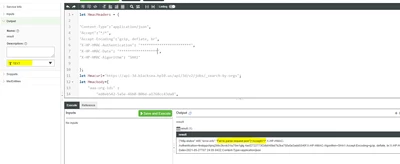

Hello Experts,
I  am using the PostJSON of ContentLoaderFunctions to retrieve some data form 3rd party application and i have this error as output:
"error-info": "Fail to parse request json",
"http-status": 400
below the code of my snippet:
let HmacHeaders = {
'Content-Type':'application/json',
'Accept':'*/*',
'Accept-Encoding':'gzip, deflate, br',
'X-HP-HMAC-Authentication': '****************************************************',
'X-HP-HMAC-Date': '2021-05-26T12:31:19.292Z',
'X-HP-HMAC-Algorithm': 'SHA1',
let Hmacurl="https://*************************/api/3d/v2/jobs/_search-by-orgs";
let Hmacbody={
"aaa-org-ids" :
"start" : "2021-05-03",
"end" : "2021-05-09",
"active" : "false"
let params = {
headers: HmacHeaders /* JSON */,
url: Hmacurl /* STRING */,
body:Hmacbody
// result: JSON
let result = Resources["ContentLoaderFunctions"].PostJSON(params);
and as output i have while i am expecting data in JSON format:
"headers": {
"Accept": "*/*",
"X-HP-HMAC-Authentication": "***************************************************",
"X-HP-HMAC-Algorithm": "SHA1",
"Accept-Encoding": "gzip, deflate, br",
"X-HP-HMAC-Date": "2021-05-26T12:31:19.292Z",
"Content-Type": "application/json"
"http-status": 400
Thanks in advance,

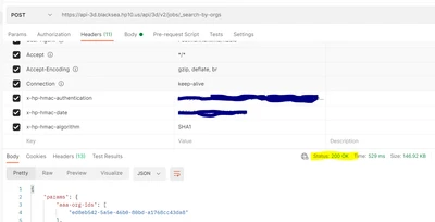

May 26, 2021
I changed to double qoute but still receiving the same error.
I have validated the request with postmanbefore moving to implement it in thingworx service, so with postman it works fine:
Youssef

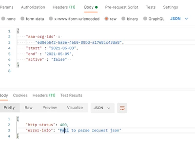

May 27, 2021
Hello Guys,
I reproduced the same error with postman changing the body json:
in postman it works fine with following format:
    "aaa-org-ids" : [
        "ed8eb542-5a5e-46b0-80bd-a1768cc43da8"
    "active" : "false"
Thingworx does not accept this json !!!!
So any idea why it does not work
