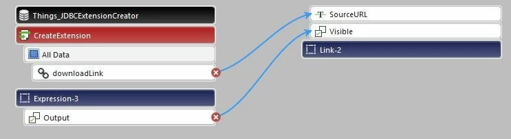

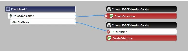

Can you please elaboate a bit that What do I have to edit in the upload mashup.
There are connections with Thing JDBCExtensionCreater, to explain in a better way I've attached the screenshots with the message.
22-Sapphire I
November 22, 2019
Click the file upload widget itself
and change a trivial setting on it.
