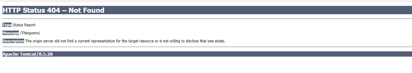

hi @Rajesh_Sayana ,
  I followed all the steps as provided here 'Please take a look at this article: Debug ThingWorx Platform and MSSQL database connectivity' .Also tried validation techniques provided by community still not fixed the problem.But still i am facing issue (attached screenshot of it) and Application log and platform-setting is attached.
I have queries:
1. which jdbc driver is used for sql server 2017.
2. Is attached platform-settings.json file correct.
3. need to set any environment variables?
Can you Please provide detailed procedure from start to end sequentially for installing thingworx 8.4 on top of SQL 2017.
I have also searched for customer care details but no success, could you please provide the customer care details as well
Please help me regarding this.
