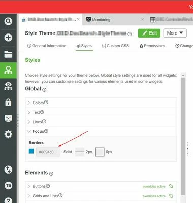

ShirishMorkhade
November 21, 2023
Hi @AC_10460579 ,
Either you must be using OOTB style theme or there must be a custom one. Go to the Style Theme that is being used in your application and do the below highlighted changes.
Shirish

March 14, 2025
Hello @NJ_10144761 ,
Please review Configuring Mashup Properties in the entry for "LegacyFocus"
If you have this check box unchecked the CSS you have should function as you expect.
Because there may be differences in presentation, What is the environment where you are not getting the look you desire?
Please review Article - CS439465 - ThingWorx Web Components Customization with CSS
In the screen capture, "Linting" is checked. You can not save the CSS with errors. Please turn off this feature. You will then be able to save the CSS update.
Let me know
Pehowe
