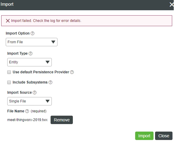

@kikky_79 Can you please provide the error details from the Applicationlog.Log?
Vibhuti
I'm having the same problem. When I click 'import' I get a text box in red stating that the import has failed and to check the log for error details. This is the first time I've used it this program. How do you get to the log to see the error details?
Thanks in advance,
CD

Hi @kikky_79 @CD-TAS.
I tested and ran into the same issue, so I have reached out to the team in charge of this learning content.  Hopefully, we will have an update soon.

Hi all,
I came across this page on how to import a file without using the Import/Export window. It suggests making a HTML to allow one to manually import a file.
http://support.ptc.com/help/thingworx_hc/thingworx_8_hc/en/#page/ThingWorx%2FHelp%2FGetting_Started%2FImportingandExportinginThingWorx%2FManuallyImportingandExporting.html%23wwID0ELNAU
I've tried it but sadly with no luck. I'm starting to think that the file itself is most probably at fault.
@CD-TAS
What errors are you seeing in the application logs when you attempt the import?
What extension version you are trying to import?
What is your Thingworx version?
You need to have Administrative permissions to import or export all entities in Thingworx. If the user is not an administrator, they can only export entities they created or have been granted design time read/update/delete permissions on. For more info: Article

I tried out the .twx file; looks like it is missing two extensions - AWS Iot Connector and the ThingWorx Analytics Extension (both available in the Marketplace).
Please download both extensions, import them and then try importing the .twx file.
We'll reach out to the relevant team and have them either exclude entities that are not required, or add/ link these extensions as part of the tutorial.
Great! Thank you so much for your help. I'll give it a go now.
