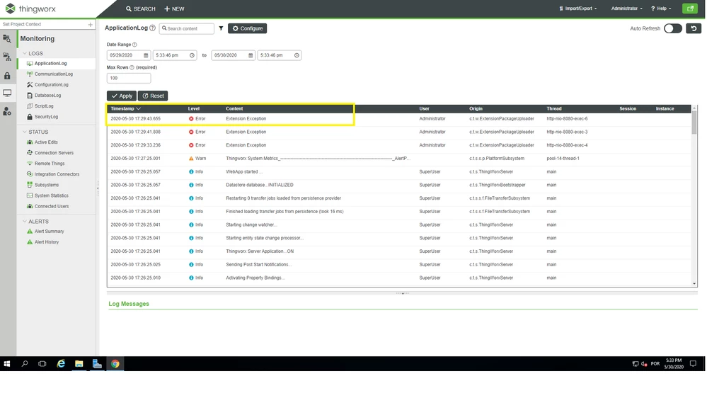

Hi everyone,
I was not able to import a extension to my platform thingworx version 8.5
Below my platform-settings.JSON and the log error:

Best answer by slangley
Hi @leokeinsfeld.
From working the case, we found that 2 instances of ThingWorx were installed.  The platform-settings.json file had been updated for the instance that wasn't working.  Once the correct one was updated and Tomcat was restarted, extensions imported successfully.
On a side note, installing multiple versions of ThingWorx on the same server/VM is not a supported configuration.  Therefore, the instance that was not working was removed.

Hi @leokeinsfeld.
Did you restart ThingWorx after updating platform-settings.json?  What extension/version are you trying to import?
Regards.
--Sharon
June 1, 2020
Hi @slangley
I have restarted the thingworx
I am trying to import the extension in attachment
Support
June 2, 2020
Hi @leokeinsfeld.
Was this downloaded from the Marketplace?  If so, you might want to try the upgraded 3.0.3 version.
