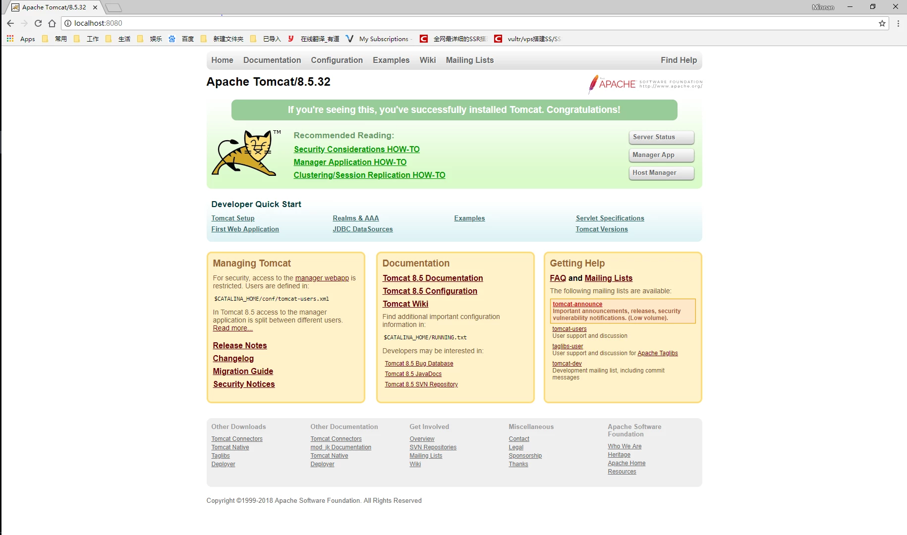

days before, i reinstall my system,from win7 to win10, both of which is 64-bit.and i am able to enter the ThingworxFoundation on win7.
after i settle all the settings, i found i can't enter ThingworxFoundation.after i reinstall the Tomcat serval times, i verify that i install Tomcat8 successfully by enter localhost:8080.

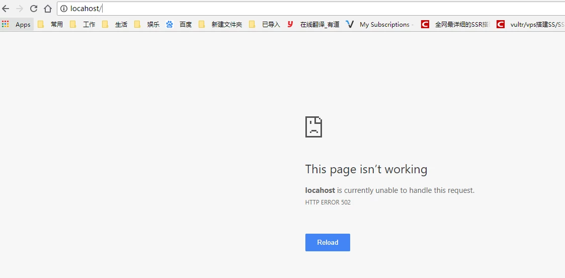

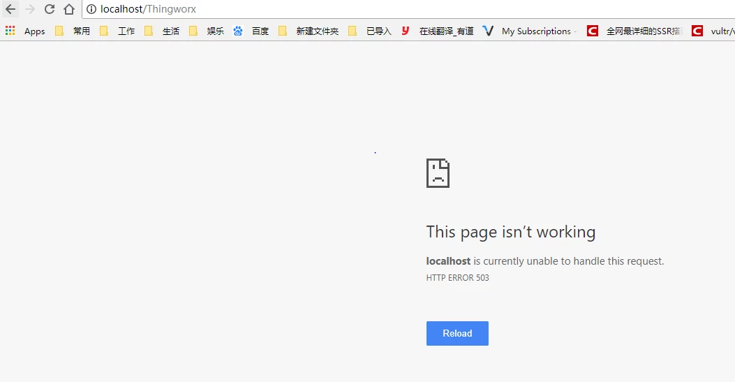

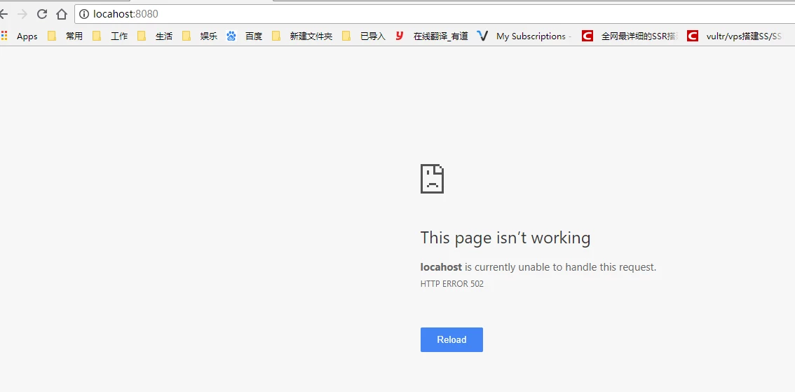

but when i put the Fadation files into their palce, and re-start Tomcat, i can't even enter Tomcat, neither at the port 8080 nor port 80.
here are some logs files in Tomcat before setting the Thingworx and after it.
