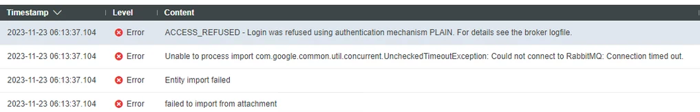

To give some context, I have created a workflow service in DEV environment in order to perform series of tasks that would send alerts. The workflow which was created is working fine as expected. However, when I tried to Import workflow in QA by exporting from the DEV environment, I am receiving following error in ThingWorx application log.
Error: ACCESS_REFUSED - Login was refused using authentication mechanism PLAIN. For details see the broker logfile
Can you please suggest how to resolved this issue?

It was found that a case was opened for this issue and the following suggestions resolved it:
For Flow Rabbit Error:
https://www.ptc.com/en/support/article/CS354781?source=search
For Flow key errors you need to re-import ThingWorx Flow Secret Keys in the ThingWorx Foundation KeyStore using this link.
