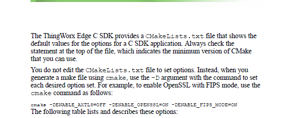

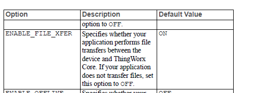

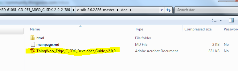

The new SDK comes with the documentation within the downloadable
Page 111 and 112 talk about building the example using the CMakelist with all of the options enabled by default:

Thank you for pointing that out.  I attempted to run cmake with the flags in order to build the applications, but when I added that I got the same errors as before.  I also noticed on the server side in the logs on the mashup I see this error:
ERROR - Error in invoking service Things_repositoryThing, LoadText, Things, repositoryThing, Services, LoadText. Error from the server: "File Does Not Exist"
