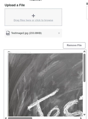

When I upload a file, it shows the file below with an "x" to remove the file as well. However, I need to remove this "x" because there is no bindable event to removing an item. Instead, I have a button to clear the items which then triggers some other services.
How do I remove the "x" button from this widget as shown below? Thingworx 9.6

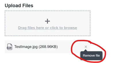

add custom css to the mashup:
@supports (ptcs-style-unit: "PTCS-FILE-UPLOAD-LIST-ITEM") {
[part=hit-area] {
display:none;
you probably need to disable linting which will keep you from saving.

When a user clicks the "x" it removes the file from the list as stated. I have a webframe directly below this that shows the file that has been selected. The "x" does NOT have a bindable event to clear this webframe when it is clicked. Therefore, I am using a button to clear the file. However, the "x" is still visible which is not desirable since it is not useable. Also, the file upload widget is disabled after a single file is uploaded which gives the "x" button no functionality. This is great, but it is still visible.
[part=hit-area] {
display:none;
