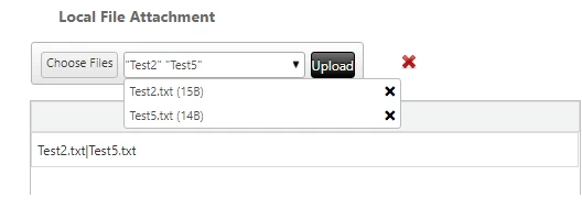

File Upload widget not clear File Item list after upload
Hello team
I am working on file upload widget and allowing to upload multiple files, but once I click on upload button the items list did not hide or clear.

Hi @shetakesubhash7.
This issue was addressed in ThingWorx 8.5.6 which was released last week.  Unfortunately, there is no workaround or patch update available for the release you are on.

In which version you notice this?
Raluca Edu
March 19, 2020
Hello Raluca,
I am using Thingworx version 8.4
Subhash
raluca_edu
March 19, 2020
Could you please be more specific: 8.4.x? I want to test it.
Raluca Edu
