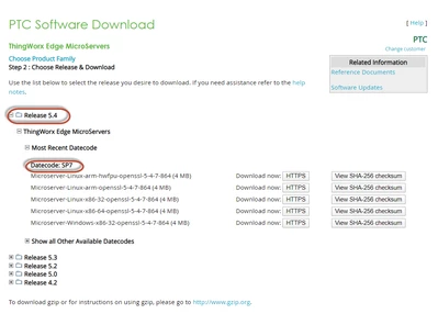

What version of EMS are you using? It is possible to be a defect corrected in the latest version of EMS.
Best regards,
Raluca Edu
mnaeem1-VisitorAuthor
February 12, 2020
Thank You @raluca_edu
I'm using SP6 also attached.
It transfers the file but after showing these errors many times.
raluca_edu
February 12, 2020
Latest version is 5.4.7, but if you are saying the file is modified while it is transferred, then it is normal that checksum to be modified also.
An approach will be to  transfer file after modification is complete or somehow avoid file modification while in transit.
